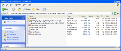

VIPC file included for dependencies (list only), repackaged Icon Editor API included as package.
How's that? Posted Image
I tried... I really did... For the life of me I can't figure out how to parse that to mean, "download the zip file if you don't have the dependency." Posted Image But like I said, I'm a little slow.
So its in the .zip version not the package version downloadable.
Are you sure about that?
But you can get it here from my post too
Ahhhhh... better. Posted Image
Yes, very :)

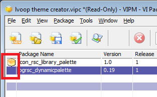

Also here is an example what I am talking about, and what the .vipc file would look like:
When the file is opened in VIPM you can see that there is an package-glyph associated with one item and no-glyph associated with the other item.
So the package-glyph means that physically that package is in the .vipc file, the no-glyph meast you need to BYO :)
All you need to do is Tools>>Apply Package Configuration to install the files.
