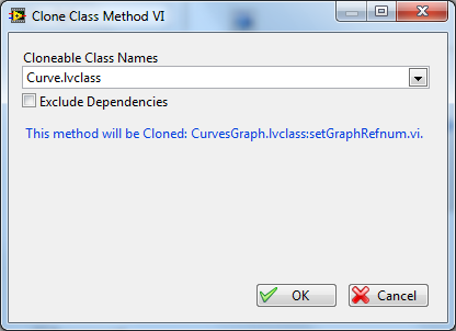

Feature Request: Clone a Method VI
I have updated the repository with a new version - you can now easily clone a method using this tool.
Supported Templates include:
4815 - 4x2x2x4
4833 - 5x3x3x5
4834 - 6x4x4x6
4835 - 8x4x4x8
(Assumes any other LVOOP Class Control is a data member or parameter).

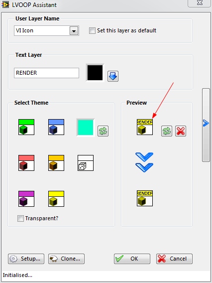

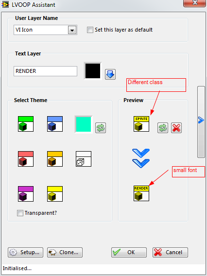

ok, here are two pics showing the behaviour
The old class seems to use a big font, but when I use the assistant on a newer class, even if I type the same text it uses a smaller font.
Yes, the reason for that is as explained above.
10-pt would still 'fit' if you always less characters.
