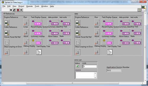

#9 John Lokanis
John Lokanis
  • 574 posts
  • Location:Seattle, WA
Posted 28 September 2010 - 09:49 PM
Your example of the 2009 also fails on my 2009 SP1 (error 91). But if I remove the strict type it works again.
All I can do is show you this. Note the run continuously and that the include data type red stars are present and the version of LV is now displayed. Must be something wrong with your version of LV2009SP1 or mine. Can anyone else confirm this?
