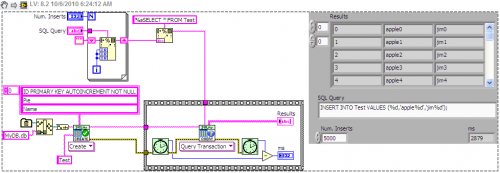

This is wonderful. I've begun implementing it in a current project and need to ask about the Query Transaction function.

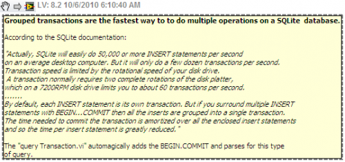

I was excited to read this comment because one of our current systems takes forever to write to our SQL Server DB. (~30 seconds. I imagine it's executing one SQL INSERT for each step it's reporting.) So, I thought I'd test this in SQLite:

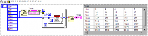

As I played with it I came up with this to see the effect of larger SQL strings:
I've tried each of the locking modes (immediate, deferred and exclusive) but it's taking almost three seconds to complete only 5000 SQL INSERT statements. This is not as fast as the documentation suggests.
What am I doing wrong?

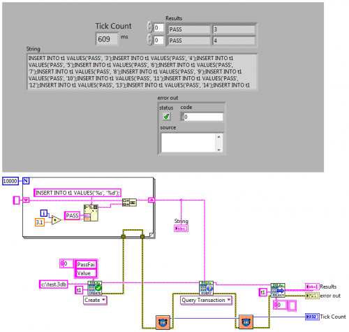

Its not the number of statements. Its the number of "TRANSACTIONS".
When you use the "INSERT" VI in a for loop, each iteration is 1 transaction. Additionally, the insert vi opens the file before the transaction and closes it afterwards for a slightly safer implementation. The insert is for convenience and a bit more safety.
If you want blistering speed. You need to use the "transaction query.vi". this will wrap your Insert statements in the "BEGIN...END" and execute all the statements as 1 transaction.
With the test below. I achieved 10,000 inserts in 609 ms.
