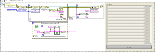

Thank you. This is what I came up with.

Practically copy-paste from mine ;) You should wire your Sequence ref through the first for loop and close it. You probably won't ever have a problem without doing that, but it's just The Right Thing To Do.

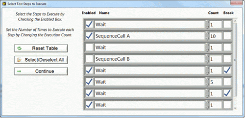

PS: this is the UI that abso was talking about. (it's part of our internal TestStand API reuse package, so it's not available for public use, but it might inspire and idea on what to do):
