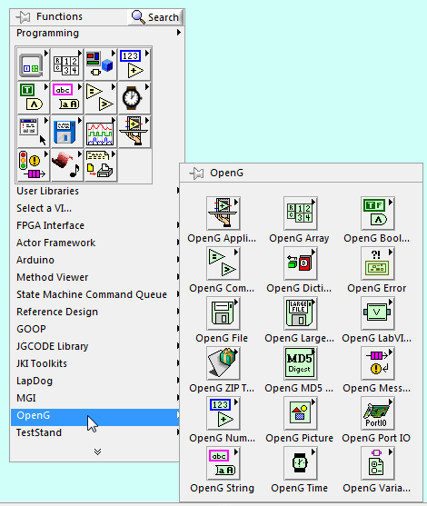

#44 neil
  • 209 posts
  • Location:Surrey, UK
  • Since:2004
Posted 07 February 2012 - 11:24 PM
View Postjgcode, on 06 February 2012 - 11:44 AM, said:
It looks worse because of Icons and Text view - this is what it looks like as Icons only (in VIPM).
I would like to be able to change this is VIPM - if anyone else does too then check out and vote for David's cool idea (and my comment!) :) on the VIPM Idea Exchange.
I don't want to move stuff around too much due to palette inertia - but here is a second attempt for comment:
possible thread derailment approaching!
While on the topic of OpenG pallettes, does anybody know an easy way to get rid of the "OpenG.." text at the bottom of all of my pallette icons? It never used to be like this...
My prefs are set to Category (standard) and all the other sub-pallettes do not have any text at the bottom. This started to happen a while (a year?) ago?
Note: this only seems to appy to the top level OpenG pallette menu, if I drill down deeper the text disappears

#45 asbo
  • V I Engineering, Inc.
  • 998 posts
  • Since:2008
Posted 08 February 2012 - 01:19 AM
The most immediate downside I see to this is that if you use Quick Drop or the search functionality, you won't be able to see whether the VI in question is OpenG or not. Whether or not this is catastrophic is up for debate.
/derailment encouraging
