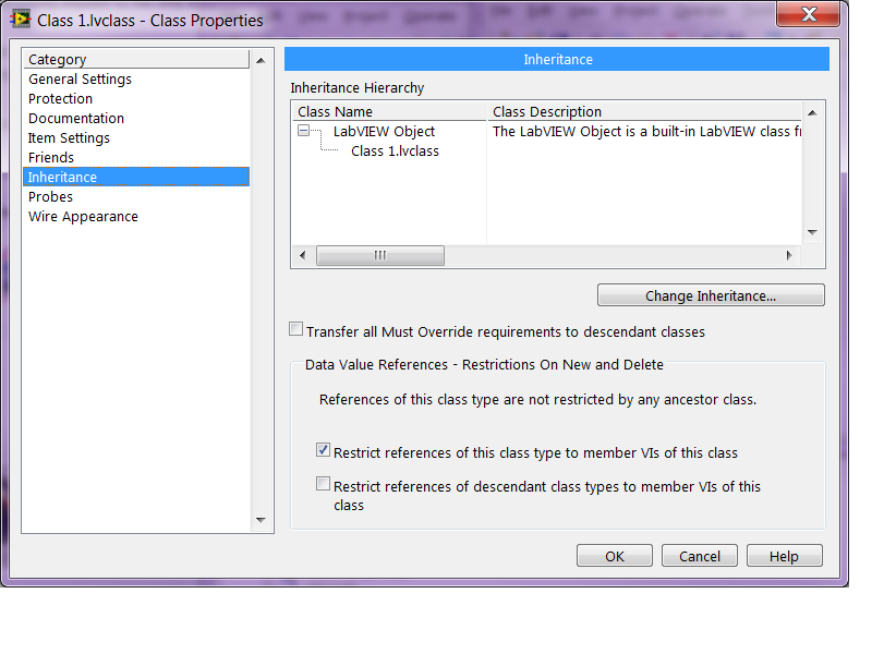

Can anybody explain to me why it is not possible to create a DVR to a class in a VI outside of that class?
Of the two images attached the first one (with the broken wire) is from a VI that is outside the class, the one that is not broken is from a VI that lives inside the class.
The error message is Polymorphic terminal cannot accept this data type
Does the DVR have to be created inside a class member VI?

It's a property setting:

Thanks Miha, :thumbup1:
Now that you mention it, I do remember changing this before when I had this problem last time, but I totally forgot about it!

In case you are wondering what is the point of this feature:
One of the reasons for doing this is so you have the ability to force the user to use your constructor method as opposed DVR'ing the object with x state.
This maybe important sometimes when you need to guarantee that any methods/setup that are required to run are indeed run, then you can DVR the object -> you have complete control.

thanks Jon. My OO experience is quite limited, so I have not really ever needed to start mucking about with those checkboxes. Your explanation does make sense though. Most of the apps I develop are really 1 person projects, so I have never really had to think too much about someone "misusing" any of my classes.

It's not just someone else misusing. It's also about making your own debugging easier as your code base expands.
