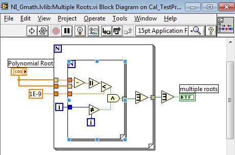

Many VIs are still very nicely written, but could be better optimized.
E.g. This VI was probably written before the for loop got the Conditional Terminal.
Posted Image
