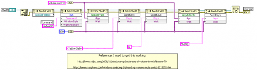

Do not know why, but this seemed a fun thing to try
So I have been playing this this off and on. I now have a VI that toggles the sound mute button, it works fine in edit highlight mode but is a little unpredictable when not highlighted, would need to play around and put a few waits in place. I am sure some LabVIEW purists will come up with a better solution
Attached Image: Example_VI_BD.png
Attached File  sound_mute_toggle.vi (20.04K)
Attachment sound_mute_toggle.vi
Thank you very much Danny. :worshippy:
I just learned how to write shell scripting in VI.
-Sharon
